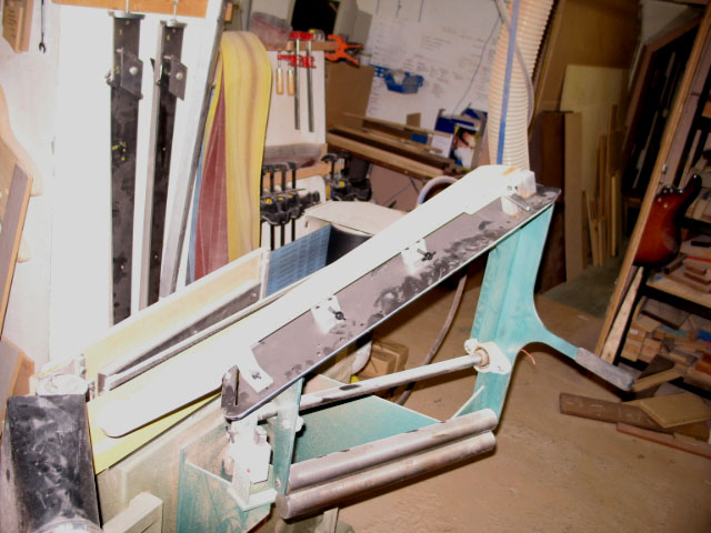

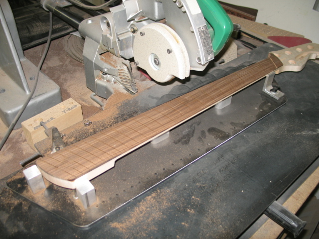

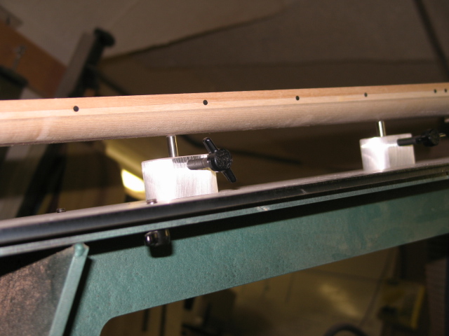

Thanks for the props.  Sorry to take so long getting some photos done.
There are a couple of close ups of the spring loaded support pins, cam lock, slotting process and a bad one of the radiusing fixture on an edge sander.

Sheldon, thanks for the photo's. How are you registering this jig to cut the fanned frets?
Paul
PostPosted: Sat Jan 05, 2008 9:59 am
Joined: Mon Dec 10, 2007 5:10 am
Posts: 10
[QUOTE=PaulK]
Paul
Two pins on the table directly inline and under the blade path.  They key into the holes on the front of the neck fixture and slots on the back.  The slots maintain side to side alignment while offering a bit of forgiveness for accuracy.  Laser cut steel is pretty accurate, but it does expand slightly as it heats up when being cut.
